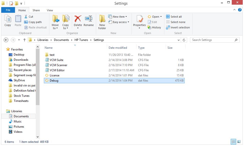

A DEBUG.DAT FILE CAN BE FOUND ON YOUR PC IN DOCUMENTSHP TUNERSSETTINGS

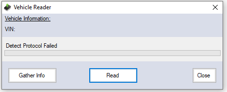

The Detect Protocol Failed error is generally caused by either noise in the vehicle's communications or an MPVI2 may need to be re-synced. If you have an MPVI2, first ensure your computer is connected to the internet, Click "Help" and choose "Resync Int...

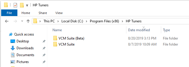

IF YOU ARE UNABLE TO LOCATE EITHER VCM EDITOR OR VCM SCANNER AFTER INSTALLATION, YOU WILL FIND THEM BOTH IN YOUR PROGRAM FILES. VCM Suite is found in:      C:Program Files (x86)HP TunersVCM Suite VCM Suite BETA is found in:      C:Program Files (x86)HP T...
